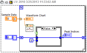

Hi Tim,
Thanks for the example.  Doesn't the peak detector point by point only return a boolean value of whether a peak or a valley exists?  I am more interested in where the peak/valley exists because that would help me with my calculations of peak frequencies.  Is there a way to do so with the pt by pt detector?
Thanks!

If you know when a peak exists, it's not terribly difficult to keep track of timing or indices or whatever you need.  For a simple example look at the attached snippet.  You could additionally keep track of a tick count or something if you need specific timing.
