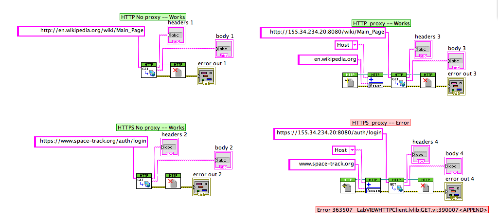

I have been trying to use LabVIEW to access an https site through our corporate firewall/proxy and have been unable to get it to work. Does anyone have any experience with this and or know whether this should be able to be done?
I have successfully been able to get LV to access websites (http and https) without going through a firewall and thanks to posts on these forums figured out how to access an http site through the firewall but have come up blank when trying any https sites. Below are some test cases I have tried. All of these sites are easily accessed via browsers so it isn't due to firewall/proxy iblocking.

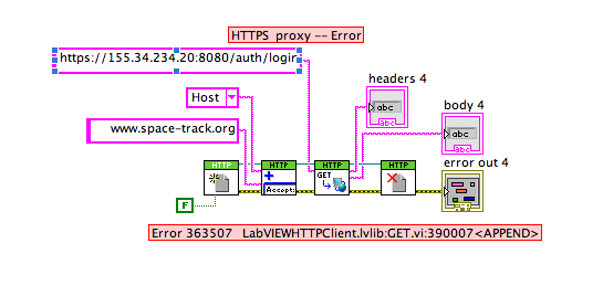

This is a server authentication error, most likely because the proxy is returning an invalid SSL certificate. If the hunch is correct, you have two options: 1) installe a valid certificate to your proxy  2) turn off "server authentcation" on the HTTP Open Handle VI.  We highly discourage the 2nd option as it opens you up to man in the middle or server impersonation attacks.

I tried option 2 of turning off verify server with False wired to the Open command as seen below but still get the same error. (Block diagram shown below). If I still get the error with verify server off, is option 1 still a possibility?

In addition to certificate problems, error 363507 also occurs when the SSL handshake fails, which would happen if the server is not listening for SSL on the a given port. I notice your two proxy examples are using the same port (8080). The proxy is would be listening on one port for HTTP and a different port for HTTPS. You don't see this problem when you are not using the proxy because the default port is different for HTTP (80) and HTTPS (443). Find out which port your proxy is configured to use for SSL, and try changing your URL to use that port instead of 8080. If that works, remove the verify server false if you can for security reasons.
