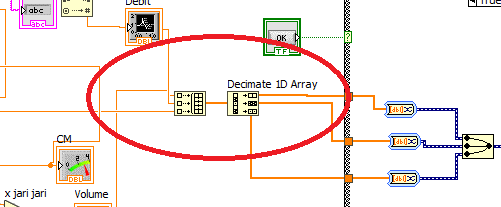

Wiring the iteration counter to the byte count input of visa read makes absolutely no sense. Can you explain why you think that was a good idea? (reading zero bytes in the first iteration, one byte on the second iterations .... and possibly millions of bytes much later?)
Why are there terminals without labels? (You can hide labels on the front panel, but don't make them empty strings!
Then you have silly code constructs e.g. as follows:
Have you done any basic LabVIEW tutorials?
(Also, when posting you would typically place code inside code tags and regular text outside, not the other way around. I fixed your post)

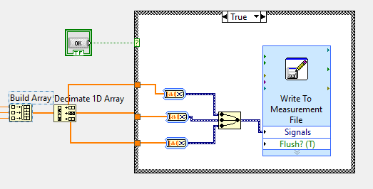

Thank you, you are very helpful, so what if I want to save the results of the sensor readings to Excel?
Message 4 of 11
(1,330 Views)
Hi Campuds,
Just do it!
I recommend to start with writing simple CSV files, using the WriteDelimitedFile function…
(Later on you can optimize your VI with using plain file functions together with ArrayToSpreadsheetString.)
Recommendation: when writing about "Excel files" you clearly should state the desired file format! Writing to CSV files is really simple as they are just text, while XLS(X) is a little more complex…)
Message 5 of 11
(1,317 Views)
@Campuds wrote:
Can i use this format?
We cannot answer because a picture cannot tell us how you configured the express vi.
And as has been mentioned before, all your data gymnastics makes no sense at all.
