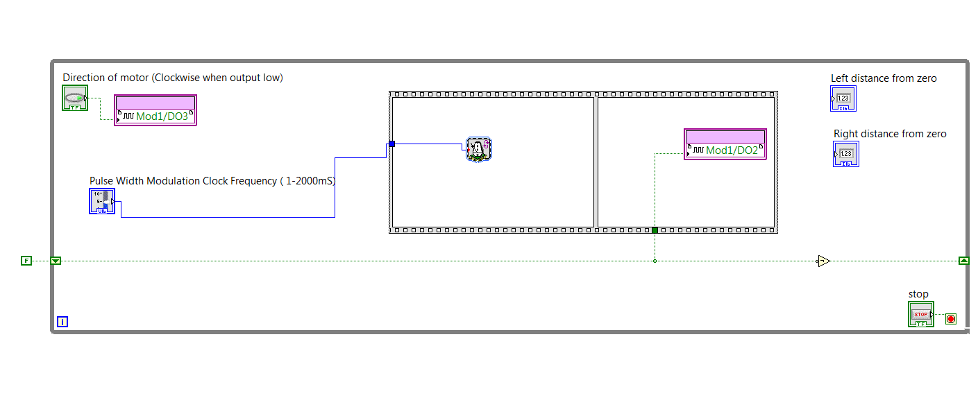

Can anyone spot the error in this code?
It's supposed to provide pulse width modulation but when I change the clock frequency control input, the output remains at 1Hz.
The speed of the modulation should be determined by the delay VI inside the sequence structure, but it seems to not be changing when I move the control.

In the future you should post the actual VI not a picture.
Because in this case we don't know how that wait until next tick is configured.  I assume it is in ms, in a 32bit form but can't know for sure from a picture.  Also in FPGA I generally just leave the loop with a constant in the stop function so it never stops.  I know this is generally bad edicate in other LabVIEW programming, but in FPGA is there ever a time you don't want your code to respond?  It's dedicated and its deterministic, and I just let it run forever.  Not that changing that would fix your issue, unless the loop stops running, at which point your Direction of motor wouldn't respond anymore either.

It is configured as you mentioned. Ok I will bear that in mind in future.
Can you see anything obvious that might be causing this problem? Its stuck at 1Hz, my control doesn't do anything.
I have attached it but I dont think the VI will give you much more. I think the issue is with the logic in my code.

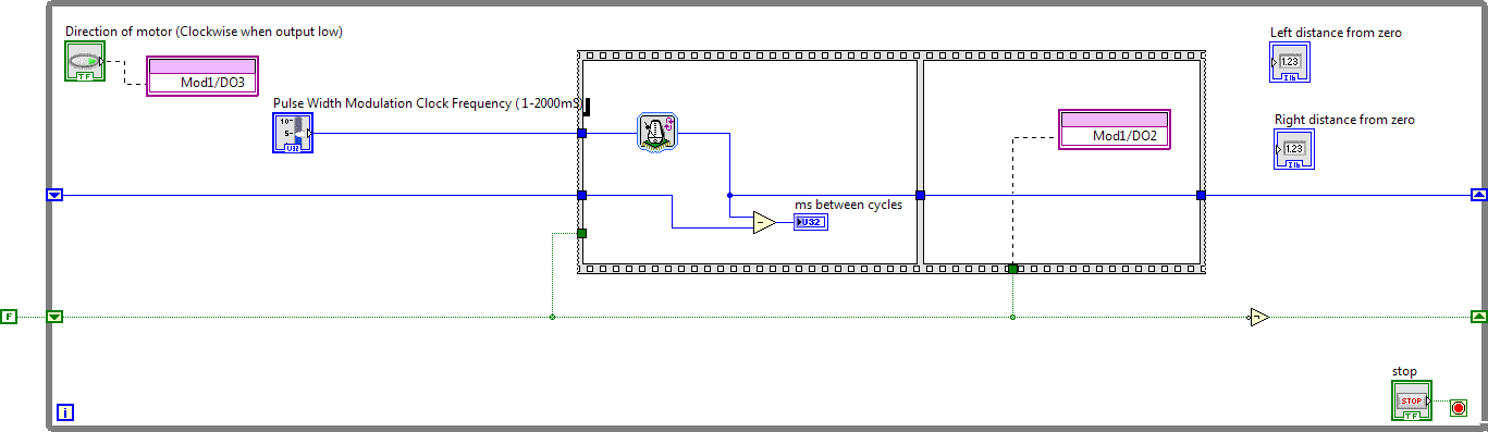

I don't see anything obvious. You've compiled this code before running it on the FPGA, right? And you're using the Run button, not Run Continously?
How are you measuring the loop frequency? I would add an indicator for the loop rate, as shown below, in case the issue is actually in how you're measuring the loop rate.
