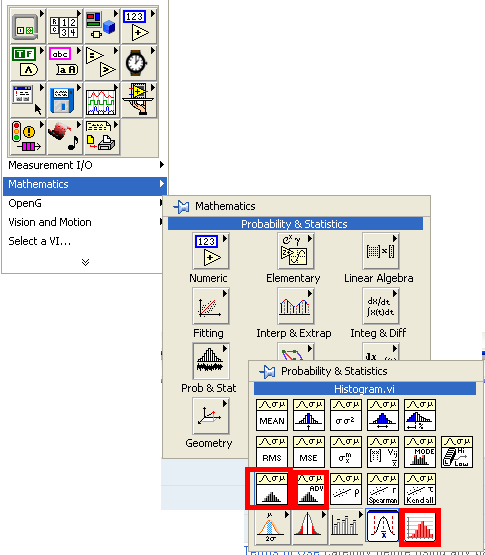

There are at least 3 histogram vi's.  Outlined in red below

If you already have histogram data (and it seems you do!), just use a waveform graph with one of the bar plot styles. Make sure to adjust x0 and dx. so the x-axis is correct.
If you need to calculate the histogram first, use Tim's suggestion.
