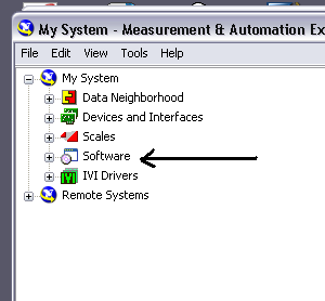

also, do they have Measurement and Automation Explorer(MAX) installed? If so, can you take a screen shot of the expanded Software list shown in the picture? Click on software and you will get a list of NI software installed on the PC.
