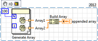

hi,
I have the two one dimensional array i need to concat and put it in the second array
array 1:  au32Array1 [100]
array 2:  au32Array2 [100]
final array :   array[0] [0....99] = au32Array1 [0 - 99]
                   array[1] [0....99] = au32Array2 [0 - 99]
how can i convert like this
regards,
Ramamoorthys

Try this:
