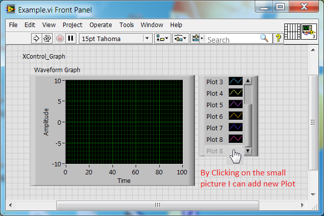

When I use this XControl_Graph.xctl in Example.vi I can not add new legend item by typing its name into uninitialized legend element (see picture below).

I observed that new plot can by added by clicking on the small picture in uninitialized legend element (see picture below).
Is it possible to prohibit this way of adding a new plot?
I tried to catch the Graph: Plot Attribute Change event in Facade.vi but it seems that adding new plot in this way does not fire this event.

Hello mavlc!
I think there is no direct method to see if you add plots, but there is a workaround that you can use. If you put in a property node of the graph and you read the value, you get it back in an Array format, there you can check the size of the array and detect if there is a change in that number.
I hope this helps with your problem.
