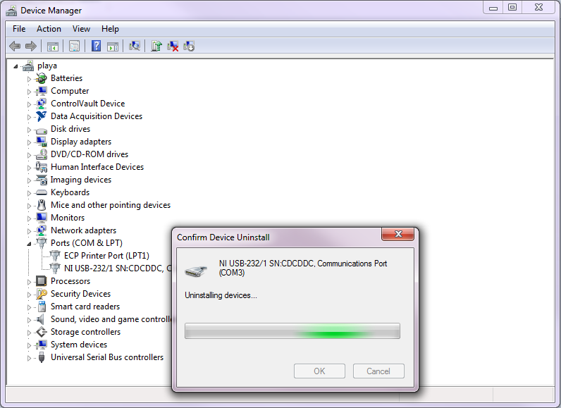

  • Oddly, this device is reported as still present in MAX even when the device has been disconnected or powered off and I can not unistall the resource via Windows Device manager (image attached). Ultimately, the attempt to uninstall the device hangs and the system will have to be rebooted.

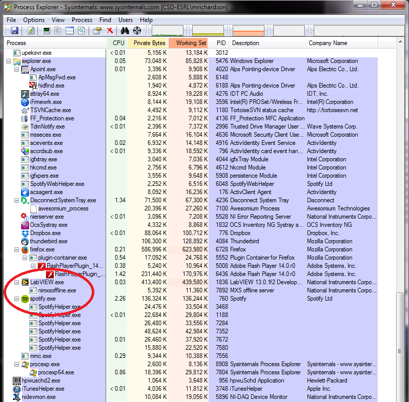

  • Looking in Process Explorer (not the Windows Task Manager), I can see a running process LabVIEW.exe with the child nimxsoffline.exe running (image attached) even though there is no obvious instance of LabVIEW running on the machine.  the process appears to be an unkillable zombie... the deadliest.
