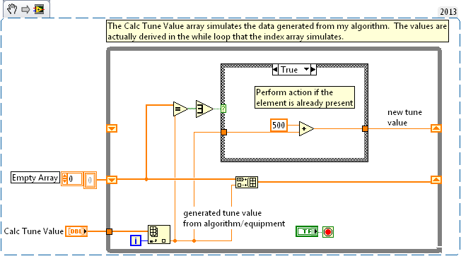

You can use a shift register and build an array by using the Tune values you generate. Then you can compare the tune value generated out of index array primitive with the shift register array and check if it has be already generated (When you cmpare you will get array of boolean output, perform an Arrya OR operation and find if the value is already present). Then you can perform action depending on the status.
I have attached an example.
