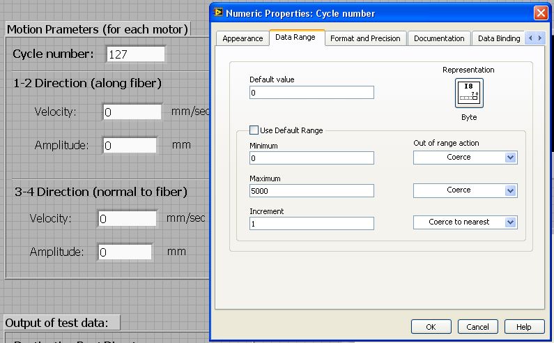

Can not set data range for a numerical control
I want to set the maximum of data range to 5000, but it always went back to default value of 127.
WHy I can not change the data range? Thanka for explanations.

Hi, you need at least 16 bit Numerical Control... definitely not anything I8 or U8.

So hit the 'Representation' button.

Thanks a lot!
