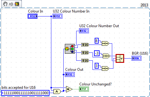

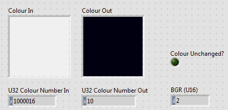

I implemented RavensFan's solution, but it does not work for white and colours close to white (grey), see screenshot, please.
Below is the code, please.

* How do I make LabView display the zeros at the begining of the binary number? The number constant in question is labeled "bits accepted for U16" in my code, no label in RavensFan code.
* Again, how do I make LabView display all the characters (zeros) in the hexadecimal number? That is, in both and only hexadecimal numbers in the code "U32 Colour Number In" and "U32 Colour Number Out").

The color you show as white is not an RGB code but a special LabVIEW code. Notice the most significant bit bit 24 (25th bit) being set to 1. With that bit set the lower significnt 16 bits are really just an index into the LabVIEW predefined colors for things like dialog background, highlight color, etc. Which also depend on your currently selected platform GUI theme. I believe 0x1000000 is transparent, which for various reasons can't be everywhere used such as for fill colors in most objects, since it is not possible to draw transparent, but instead requires the draw algorithme to inverse the normal draw logic in many situations.

In my Message 14, the output is falsely assigned in the attached VI. This was the reason for false output. Thank you all!
Edit: No, it was is not the only error. I do not understand: the white colour is still as black at the U16 output.

As Rolf said, you picked a "special" color.  A u32 that maps to the windows system settings color.  It isn't white, it is "Panel & Object" that would be selected from the System section of the lower right part of the Color Picker dialog box.  Once you strip off the highend byte (the one  before the RGB), you are left with something closer to black.
You need to pick your white of the regular "User" colors, or using the Palette button that let's you pick a custom color out of the color dialog box.

Thank you RavensFan for pointing me to the right direction -- I think, I was (still) lost in translation when reading Rolf's explanaition for the third time.
