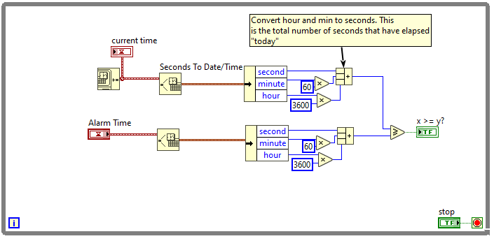

Hi, it helps!
Based on the link given by you, I managed to call the sub VI and open up its front panel. Also, when I tried to stop the sub VI, it is working. but the only issue is the sub VI window doesn't close even though i have configured this option.
I understand that I need to carry out another step - "build a connector pane". This is where I'm stuck despite trying to follow the instructions in the help file on building a connector pane.

So sorry. I managed to find a close VI control that can solve the problem. :smileyhappy:
