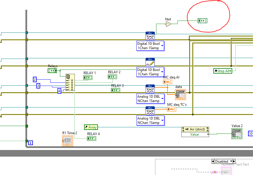

Can someone please help me find a way to pause my VI programmatically? Not abort/stop, but pause then resume where I left off.
So once you click on RUN, then  start test. You will notice the relay 1, 2, 3, and 4 keep turning On and off one after the other. So I want to be able to pause the run then continue where I left off. The way I would like to do it is when the circled indicator shown on the picture is ON for more than 2 seconds, I want the run to stop. I have tried to use it as local variable and use the >= 2 secs block and didn't work. Maybe I was doing it wrong.  The thing is I keep getting lag when using local variable.
I've been struggling to find a way to do it. Can someone please help me? I have attached my  main VI, including the type def VI used.

You need a shift register on the loop that stores the starting time of the boolean transition from False to True.    If the input is False, reset the time to current. When the current time minus the transition time is greater than 2 seconds, run an inner loop that only reads the digital input.  When the input is False, exit the inner loop and continue running the outer loop.
