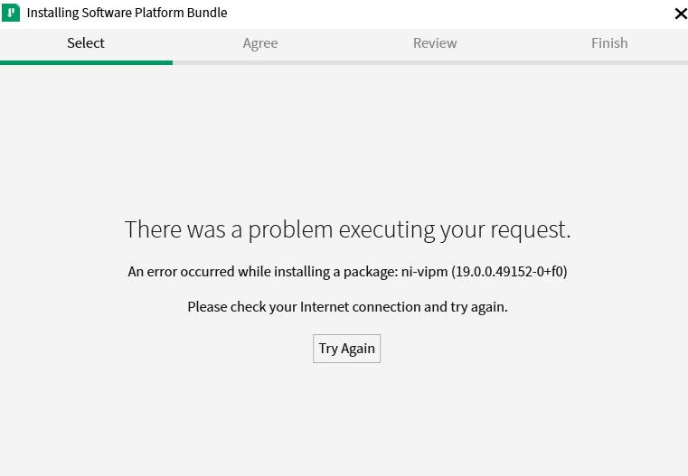

While trying to install the LabView programming environment along with the JKI VI Package Manager, I always receive the following error. I have tried installing LabView without the Package MAnager but get the same results. What should I do?Screenshot 2020-09-21 104305.png.

Now, LabVIEW is larger, more complex, many "versions" (32-bit/64-bit, LabVIEW vs NXG), and is now managed by NI Package Manager (which has its own "growing pains").  The error you are seeing ("Please check your Internet connection") is the classic NIPM "Oops, Unknown Error" message.
My guess is that you attempted to do an "Install everything all at once", which should work, but (in my experience) doesn't always  There are numerous replies here on the Forum that discuss suggestions about how to install LabVIEW (and how to uninstall it safely so you can "start over").

Oh no the dreaded ni-vipm Please check your internet connection message.
  1. Please check your internet connection is a red herring and must be the default error message
  2. NI Package Manager 2020 is a mess I have more than one ticket in for NI-VIPM Issues
