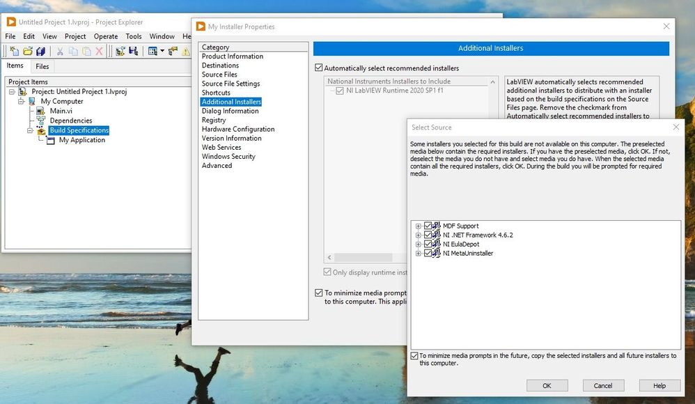

I have LV2020 Professional. With application builder I created a exe, now I need to create an installer.
When I click "build installer", I get the attached screen, where Labview asks for missing packages/modules (which I dont use by the way).
Now I dont have the media, because I installed the product via VLM, using packages.
How can I solve this?
I downloaded the Labview 2020 SP1 media iso, and have it on letter drive, but it seems it doesnt have "OLD" installer modules, it has the new package technology.
I dont want to use package installer, I need to create an old installer.
Pls help
thanks

That sort of looks like you are simply missing an EULA update.  I am guessing that any one of those preselected media is enough.  I'd try installing the missing LabVIEW 2020 RTE f1 patch first and see if that resolves it.

When you install a product via NI Package Manager (regardless if it's from VLM or not), it also caches a copy of the files necessary for the classic\legacy installer builder to use as the source MSIs. That it's prompting for all of those low-level components means that installer cache is possibly missing or damaged. A potential way to fix this is to run repair by:
  • From the Start Menu, launching NI Package Manager.
  • Going to the install tab, and click the products that are included in your deployment, such as LabVIEW or any driver.
  • Let the repair run - it might take a while.
  • Now try building your deployment again.
Message 7 of 9
(4,969 Views)
I UNINSTALLED ALL (labview and every NI driver) and cleared all, rebooted.
REINSTALLED Only Labview 2020 SP1 and activated on our VLM server.
It was downloaded OFFLINE installer from the NI website (1.86 GB iso, that has a NI package manager technology installer)
I created a blank project, with main.vi with just a numeric indicator.
I created an EXE.
I created an installer for this EXE.
And I get this:
HOW ??? WHY????
Pls help, this NEVER occured when I had ACTUAL media, this is NI PACKAGE technology FAULT.
This is UNACCEPTABLE unclear, it's LOW QUALITY from NI, guess why it's going down the drain
Message 8 of 9
(4,946 Views)
Done repair on ALL packages (select all -> repair).
it works.
Still dont understand why a full clear uninstall-install cycle didnt work.
Kudoed and reported as solution.
thanks
