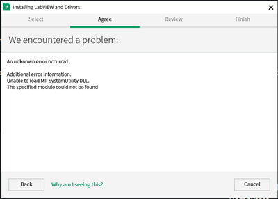

When I try to install LabView I keep getting this error and I can't uninstall the software to reinstall it as it says the uninstaller cannot be found.
Any help would be appreciated. Thanks

It seems like something in your NI Package Manager (NIPM) installation has gotten damaged. My suggestion is to:
  1. Uninstall NIPM by going to Control Panel, Uninstall a Program, choose "NI Package Manager", then Uninstall it. Follow the dialogs to remove it. Note that it will not remove any other NI software.
  2. Download and install the latest NIPM installer from here:https://www.ni.com/en-us/support/downloads/software-products/download.package-manager.html
  3. Try your LabVIEW installation or uninstallation again.

Just tried that, no change. Same error

Which LabVIEW version are you trying to install? With the older ones that came on disk and USB drive, you could force a reinstall by navigating to the folder with the installation files (as administrator in command prompt) and running the following:
setup.exe /reinstall
