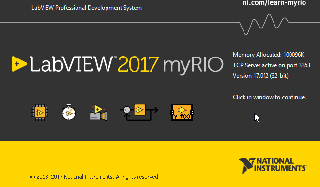

I'm working on myRIO project and i was searching for some information about ultrasonic sensor. I've got a myRIO project that is related to this topic and I also found some other VI on the internet that seemed to do what I'm trying to do. But i'm not able to open them.
When i double click on one of them (project or some VI) in windows file explorer it launches LabVIEW and no project or VI is opened. It just opens LabVIEW and that's it.
When i'm trying to open project or VI from LabVIEW also absolutely nothing happens - no error whatsoever.
I also tried to add single VI to blank project and i get this warning: "has been deleted, renamed or moved on disk".
Even stranger is that my friend was able to open them just fine and I have no clue what is wrong with my computer/LabVIEW. There is no error telling me what is wrong and I'm helpless.
I have LabVIEW 2017 with installed myRIO. I made clean installation of LabVIEW so I removed my previous version of LabVIEW 64-bit and installed new LabVIEW 32-bit and everything else from LabVIEW 2017 myRIO Software Bundle Web Installer recomended on this site. Including FPGA module etc.
