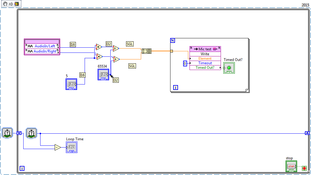

It was my mistake, I used fixed point conversion on the data as I am not expecting the values to be over +-1.
I understood, the calculation but when I perform this calculation on mic data, I am getting values around 16  times less values than the values coming on the RT side.
I tried several things, I suppose I am doing some mistake in the data conversions or division of FPGA.!
Here using simple numerical operations from Numerical pallette.
With this VI, eventually I am getting around 16 times less values than the original ( RT side values)
Another version on which I am keenly interested is using Fixed point conversion, but I dont know why with this I am getting 0 value.
Please check the VIs attached below.
