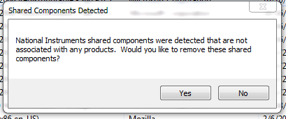

So in trouble shooting a VXI issue I decided to remove all NI stuff and start clean.
Silly me thought I could simply go to the control panel and select "Uninstall all National Instruments Products" and that would uninstall all of the National Instruments products from my computer.
Turns out that is not the case as I still have an entry for National Instruments Software in programs and features and it still shows the shared components are installed.
All attempts to uninstall the shared components end with the dreaded ERROR 1612
Looking through the forum I see 1612 is a corrupted install database and since MSI Blast is no longer offored the only way to fix it is to do a repair of the products that get the error.
BUT I cannot to a repair because there is NO REPAIR OPTION in the National Instruments unistaller.
Also running C:\Program Files (x86)\National Instruments\Shared\NIUninstaller\Uninst.exe has the same results.
