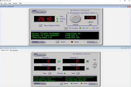

I'm trying to implement both a Thorlabs TEC Controller TTC001 and a PZMotor Controller TIM101 in one LabView script. I'm fairly certain the drivers are working, since the APT User software can recognize and control the two interfaces easily, at the same time:
