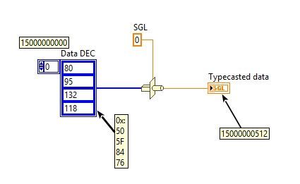

I am retrieving data from a database, consisting of an array of 4 bytes. The expected value from the database is 15000000000.
When I typecast the array to a single, somehow the value I end up with is 15000000512.
I have verified the data from the array by converting them to Hex (50 5F 84 76) and converted it using the online converter https://www.scadacore.com/tools/programming-calculators/online-hex-converter/ which works fine and returns the expected value of 1500000000.
Can someone help me to understand what goes wrong with the typecast, and how I can convert the data correctly.
Please see picture below:

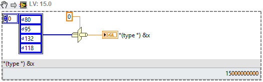

I didn't experience the same thing using LabVIEW 2019 32-bit.
My numeric values are U8s. Is that the same for you?

When I make that VI, I get 15000000000 as expected (not 1500000000, but that's probably a typo).
Either you looked wrong, or you have some hidden error in your code, that can't be spotted from an image.
Post the VI if you want us to have a look.

While SGLs are 32-bits wide, 8 of those bits are lost to the exponent, so once you get above 2^24 (roughly 7-digits), you can no longer represent every integer value.  What you are seeing is the closest integer value that can be represented by a SGL, no errors.  Different manifestation of the usual floating-point issues we see around here (large values instead of small).
Use a U32 or I32 instead and you will get the desired value, exactly.

I'm also seeing 15000000512 when using an array of U8's.  LV2016.
Actually, I copied the SGL indicator, made it a control, and fiddled with incrementing.   Sure enough, it looks like a SGL cannot exactly represent 15000000000, so it's stuck giving you one of the near neighbors it *CAN* represent.

In both 2013 and 2018 I get 15000000000.
A sgl cannot represent all values, no argument there.
But it can represent 15000000000 on my computer. This is pretty well defined in IEEE 754, and should be exactly the same on all computers that use IEEE 754 floating point numbers..

Can you try the snippet cbutcher posted?

The clever folks at NI try to insulate us from these strange effects with a little trick.  The default Display Format of a SGL is 6 digits.  You need to push that up to see the actual value.

Never mind. Found the problem.
The default display format for a float is 6 significant digits.
So that means only 150000 is displayed, the other decimals are always 0. So it's displayed as 15000000000.
When switching to digits of precision, I get 15000000512.
As expected, but sloppy of the online calculator, that apparently also uses 6 significant digits.

Bummer. I increased the display but clearly not enough...
Expected something like the above explanation but was surprised I didn't get the same result. Oops!
