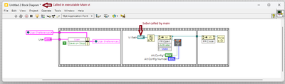

I wrote some software that lets me manipulate the front panel settings (Mod FP.vi) and save them in a config file so I can hopefully load the front panel in different states based on who is using it. Assuming all of that works in an executable form, I am now trying to make some software that will let me open and manipulate the front panel of any of my subvi without Mod FP.vi being called by the Vi I want to manipulate. The bit of code I am testing this concept with gets a reference to the subvi by using Open VI Reference, but I think this might fall apart once I turn this into an executable, because within the executable that path just doesn't exist. This code right now works exactly the way I want it to, but I don't know how this works when it becomes an executable.

Thanks, this was ridiculously helpful.
The StaticVi reference seems like the way to go for me, that being said...
I have been doing this:
The entire time, I had no idea the ApplicationDir was a thing.

Hi McGurt,
instead of using string functions an drelying on specific chars to denote folders ("\") you should use the BuildPath/StripPath functions!!!

In addition to what Gerd just said, you should also use the application directory instead of current VI path.
(Using string functions on paths is also dangerous, because they will all break on a different OS and there is the potential to make illegal file names.)
