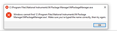

 Secondly.. I decided to delete any NI files that had been downloaded / installed and start from scratch. Now, after I download the installer, I cant even open it, and instead get the error below.
Hopefully someone can help me - thanks!!
