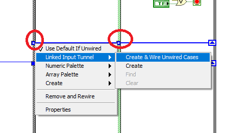

You have two output tunnels with the array that have "use default if unwired" and they are not wired. This will pass out an empty array. Once you have an empty array you can't replace any elements.
(3,267 Views)
Steven is right.
The easiest way to fix would be to right-click the hollow output tunnel and use the linked tunnel feature. (If no wire exist, you need to tell it where the linked tunnel is)

Thank you very much StevenD and altenbach for your quick response! It really solved my problem 🙂
