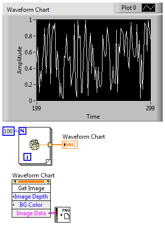

I am trying to capture the waveform from the waveform chart save it as an image.
The reason I am not saving the data is that we have a lot of test data and we do not want to plot hundreds of waveform again manually.
Does anyone know how to do it?
Thanks!

Here's an easy way to save an image of the chart.
You can save only the chart as BMP, EPS, EMF or PICT with another method:

Thank you!
