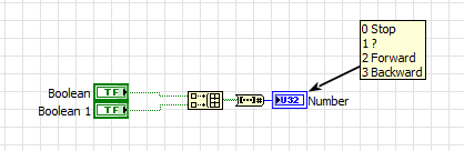

I imagine there is a better way to do owhat you want than what you are trying to do.  But you could use Build Array and the Boolean Array To Number.  You could then wire that number to the case selector.  For two booleans, you will have cases of 0 (F-F), 1 (F-T), 2 (T-F), and 3 (T-T).

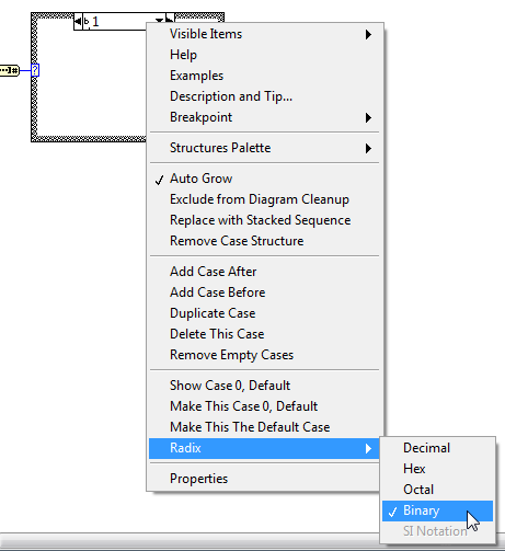

Or, Boolean Array to Number and show the radix in the Case structure.
2015-01-09 14_18_08-Untitled 3 Block Diagram on TCPT CAN ESS.lvproj_My Computer _.png
Jim

You could do something like this but what about the True-False case?

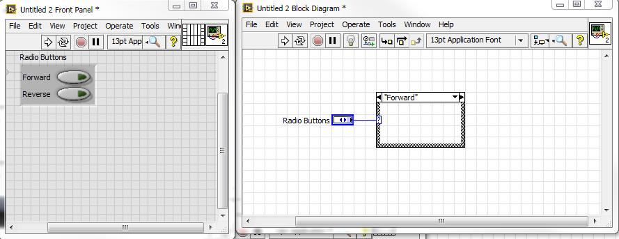

You should be using "Radio Buttons" for this.
Radio buttons allow only one selection (or none) and it's output can be fed right onto a case structure.
Radio buttons don't quite work that way.    You can have no selections when you first start, but as soon as you hit one button, you can never "unhit" it.  You'll always have one button pressed anytime after you've pressed any button for the first time.  You can only have the "false-false" condition up to the first time you ever hit any button.
Message 9 of 11
(6,161 Views)
 All you need to do is "right-click...allow no selection". 😄 Now clicking the currently active selection will uncheck it.
