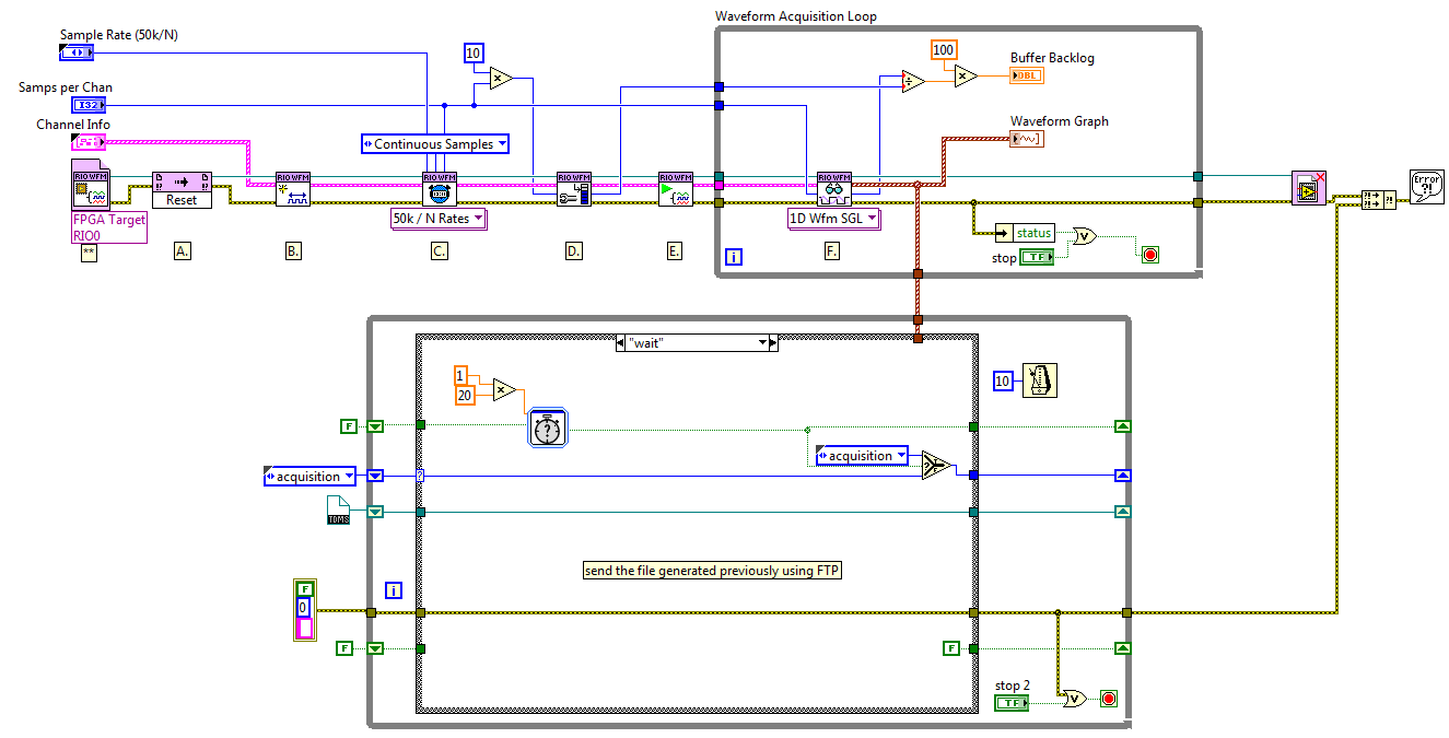

 Unfortunately I'm here again because when I run the program, the acquisition doesn't work. I don't know what I'm doing wrong, any help will be thanks 😉
Message 23 of 37

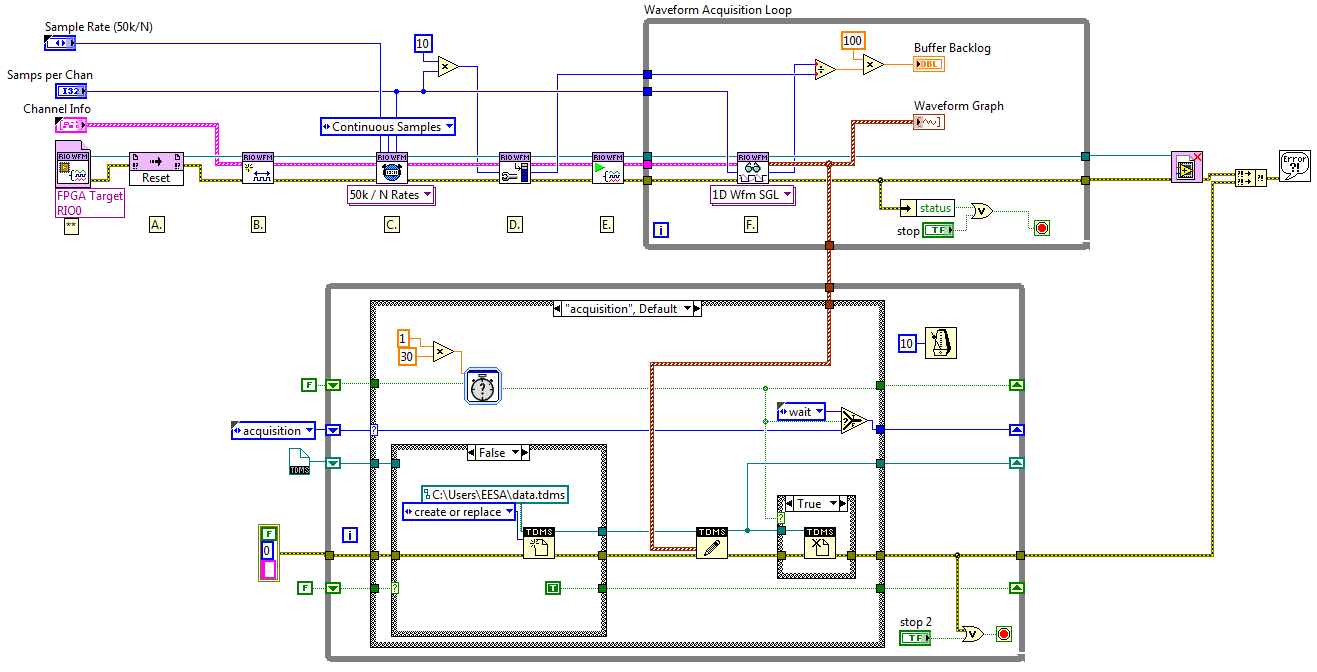

Hi again! The program works fine, but now I've an other type of problem. A TDMS file is sent every fixed time, but the second file is not stored. FileZilla shows that the transfer has been succesfull, but the problem is that the file has the same name and FileZilla doesn't change the name of the file (e.g: the new file could be named data(1), and the following ones data(2), data(3)...) and it's not stored. Do you know any solution to this problem? I've thought that if FileZilla configuration can't solve this problem, I should change the name of the data file every time a new acquisition is done, but I'm not sure how to do it.
Thanks!!

Can you please post your vi..There are a few issues that need to be fixed
  • there are no need for 2 'stop' controls
  • data flow of the error lines are not ultilized properly (wiring all lines to force execution)
  • and if it is a matter of naming the file something new ( a shift register comes to mind to increment a new name from a preset array of names, numbers or whatever..Once the acquisition is done with the necessary build path functions for renaming file and file path)

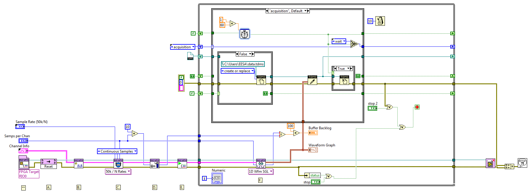

But should I create a new while loop (inside the case structure) to implement the shift register? Because each acq has many iterations. The name needs to be changed in the part of creating file and also where the file is sended (FTP).
One question that I forgot to ask, with Wait Until Next ms Multiple, don't I loose any data betwen loops?
Thanks 😉

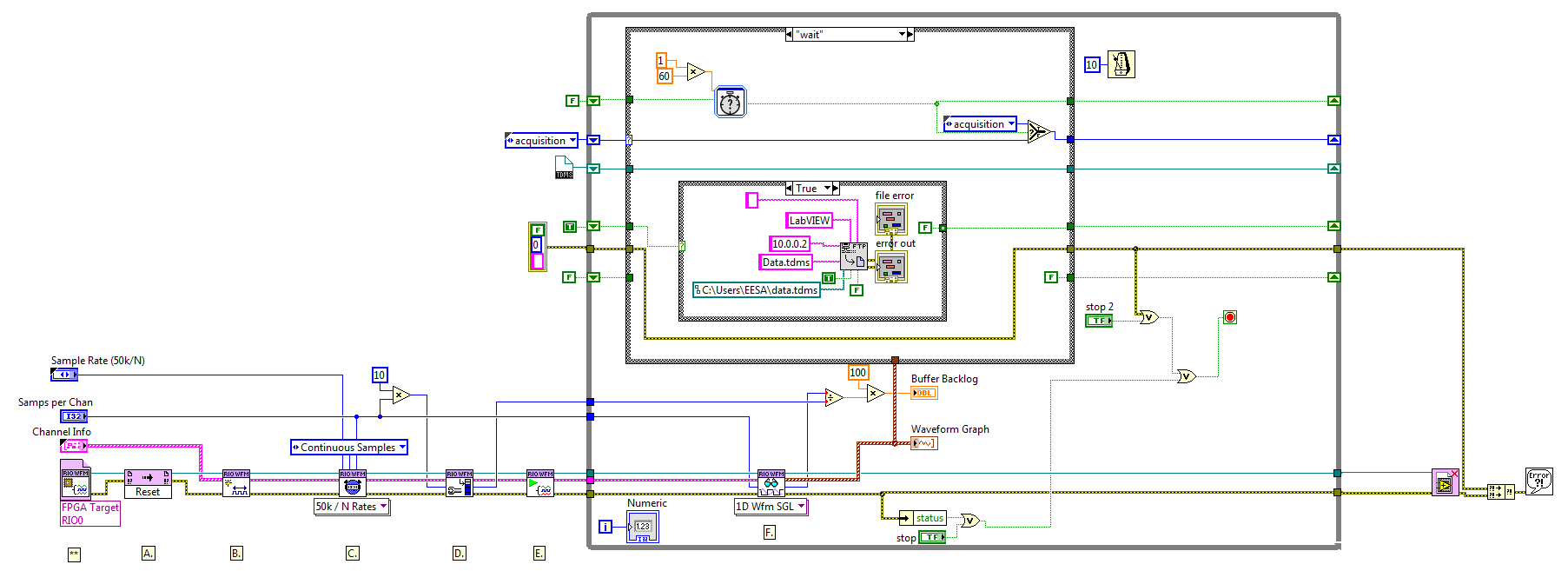

But the problem that I see now is that every time I create a new file, it will be stored in RT's memory and finally it will be full. That's the reason why I tried to replace the file every acquisition...
Message 29 of 37
(1,697 Views)
is it not as simple as deleting it after it is send over?
