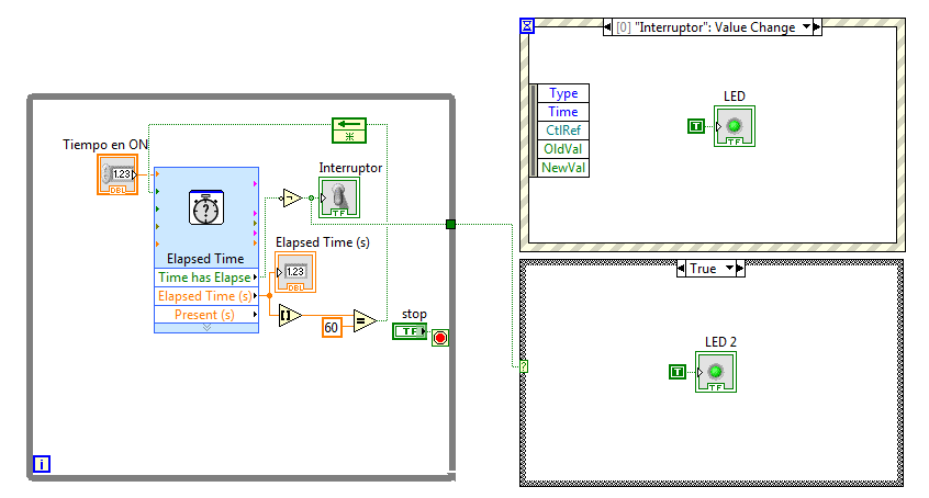

I've read many posts but I can't solve my problem. I want to implement a case structure and event structure, and the condition to execute the code inside is a boolean indicator, in this case called Interruptor (screenshot). I know that I should use Value signal property, but I don't know how implement it. Here's the program:

The Value signaling ( and other property's ) are avaleble by clicking with the right mouse button on the interuptor, select create, propperty node and then select the correct propperty.
an other option is to criate and work with dynamic events

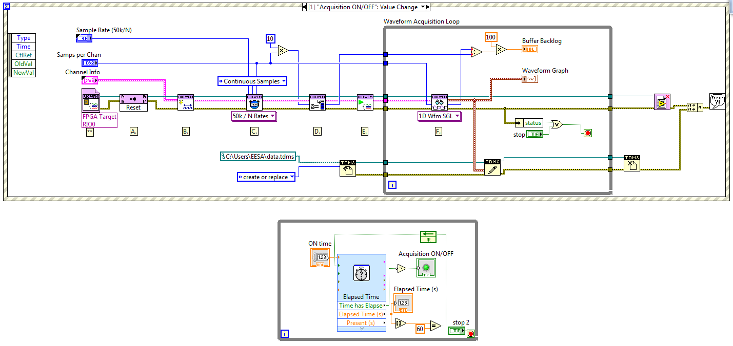

I want to program an acquisition during 2 minutes and wait 5 minutes to start it again. Screenshot:
PD: If I have a flat sequence in a while structure, when the last sequence is ended it starts again in the first sequence?

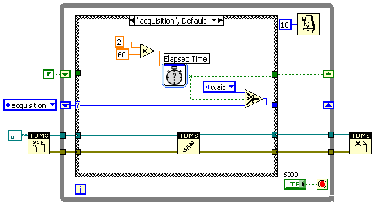

I think you might be better off making a state machine.  States I'm seeing here are Start Aquisition, Wait, Log Data, Stop Acquisition.  From the wait state, you can figure out if you want to abort, continue logging, or keep waiting your 5 minutes.  That would be easier and a lot more extensible than trying to figure a communications between loops that just cause an action to happen every so often.

a state machine with elapsed timer...

I didn't know anything about state machines and it's so interesting. The program that you put was exactly what I wanted to make except one thing. The data is stored in the same tdms file every time it starts the acquisition again, and in my case, I want to send one data file (2 minutes acquisition) to the PC (using FTP Put File). So I want to put this FTP Put File.vi in the wait state. And then when the acquisition state starts again, a TDMS file will be created (replacing the other). Any advice to do that?
