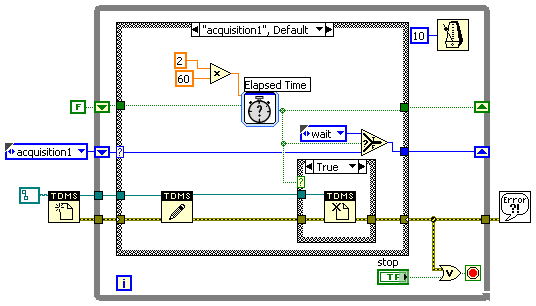

ok, you still did not answer the questions completely ( about cycling,terminate, user interface?)...this vi will (step by step):
  • goto case statement 'acquisition1' and write data for 2 mins. , then close file in T/F case statement, goto case statement 'wait'
  • wait for 5 mins goto case statement 'acquisition2'
  • generate TDMS random data for 2 mins, goto 'wait'
  • cylcle through 'wait' and 'generate random data'.....
by the way,it is always a good practice to type def your case statement enums incase you have to add more statement commands...Smiley Wink

  • i added acq2 because you wanted "to replace this TDMS file by the TDMS file generated in next acquisition."
  • your vi is constantly opening a TDMS reference, because the elapsed timer outputs a false for 2 mins...not good!, leave it on the outside of the while loop
if you write a step by step explanation of sequences of what exactly you want done here...we can better understand your intentions Smiley Wink

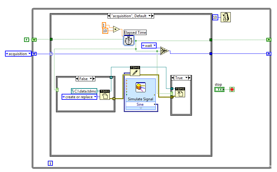

Have a look at the .llb that I've upload, it's yours but changing acq2 and adding a signal generated. The problem as you can see is that the second acq is not done, I can only see the first tdms file generated.
Thanks 😉

i see what you are doing...i am trying to understand you here Smiley Wink
is what you are doing is what i had mentioned in the previous post?...replace the file at every acquisition, then wait?
Message 18 of 37
(1,377 Views)
I want to make an acquisition of 2 minutes. Then stop 5 minutes (at this time I want to send the file generated previously using FTP). After this 5 minutes, start an other acquisition of 2 minutes replacing the file that was created in the first acquisition (because I've sent this file from to RT to PC, so I don't mind if it's replaced). And I want to do that infine times until I put stop 😉
