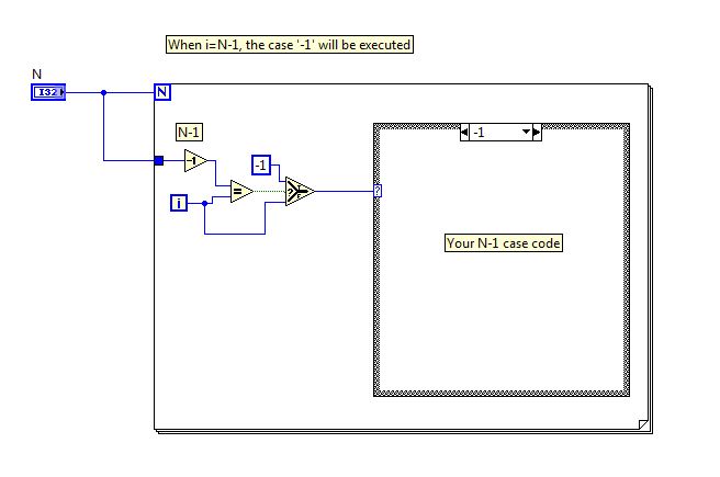

So I was wondering if we could create a case in a case structure, that's based on a parameter.
So here is what I mean:
I have a case structure inside a for loop (i=0,..,N-1). I would like for the case structure to have 3 cases: default, i=0 and i=N-1.
The problem is that N can change from time to time. It is not a fixed value.
Therefore, is it possible to create a case that's litterally "N-1" ?

No.
But why couldn't you put the N into the equation that determines which case to run.  You do the calcualtions and comparisons in the code leading up to the selector terminal.

Maybe something like this:
