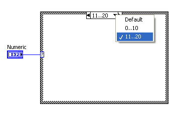

I think you can do this quiet easily with a normal case structure.
To handle numbers between 0 and 10, just type "0..10" in the case selector, and so on, like in the picture attached.
That should do it! Note, you will have to include a Default case to handle numbers below zero or above 20 in my case...
