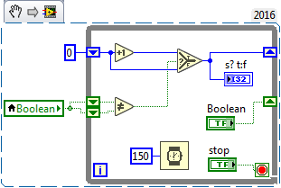

Do you need a Case Structure? Or it was just an idea?
I made this, check out if it does what you need.

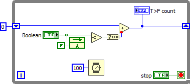

Right off the top of my head I would do this...

@Ash_zh wrote:
whenever a boolean does true/false loop inside a while loop, that's 1 cycle.
You need to define what "true/false" actually means. Your description is ambiguous.
  1. Going form TRUE to FALSE? (T>F)
  2. Going from FALSE to TRUE? (F>T)
  3. Boolean changes (T>F or F>T)
Let's assume you want to count whenever it goes from TRUE to FALSE. Here's what I would do. It can easily adapted for the other conditions by changing the comparison. (larger, smaller, not equal).
(Of course I am assuming that you are polling some real data from an instrument. If it is just a button, an event structure seems a better choice because you don't need to spin the loop unless the value changes.)
It seems incorrect to use an expanded shift register and compare the i-1 and i-2 values. Typically one would use a plain shift register (or feedback node as in my example) and compare the current value (from the terminal!) with the immediately previous value (i-1) from the shift register.
Message 6 of 11
(10,271 Views)
@altenbach  ha escrito:
You are right! Thanks for the observation 🙂

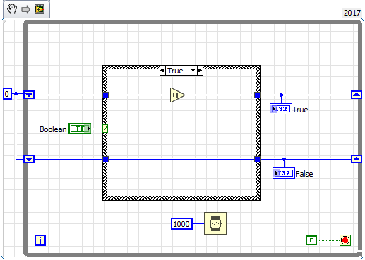

I have a case structure inside a while loop.
Case structure is controlled by a boolean (T/F).
For my test, boolean ON(true) and OFF(false) represents 1 cycle. (Boolean default position is OFF)
I need to count every cycle and not every loop iteration.

I think you can use the code from altenbach, set the comparison to not equal and then divide the number (counter) by two.
My Channel: https://www.youtube.com/@LV_Lab
You are still not concise enough. It cannot be ON -AND- OFF at the same time of course, so don't say "and"., so do you want to count (1) all changes, (2) all raising edges or (3) all falling edges. My solution above has information for all three. (It does not matter if the boolean is also connected to a case structure)
If you want to count e.g. cycles (e.g. OFF-ON-OFF), that's the same as (OFF-ON), except you need to adjust based on the last boolean value.
