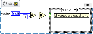

Accepted by topic author Mark87
Hi mark,
where is your problem?
Message 3 of 10
(5,142 Views)
Thanks for your answer.You've been very helpful.

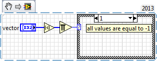

Hi Jeff,
what happens in your snippet for an input array of [1, 1, -1, -1]?
Message 6 of 10
(5,036 Views)
He would have found the bug and done it your way.Smiley Wink

@GerdW wrote:
Hi Jeff,
Smiley Surprised
You're right of course.  I know there has got too be a bitwise way to work on the array though.  Increment and sum array can be spoofed as easilly.
The point being: to not need to compare every value of the array.   What a waste if machine cycles! since we only care if any bit is 0  why compare them all).  Although I should have taken a bit of time to think it through just a "bit" more.Smiley Tongue (insert rimshot!)

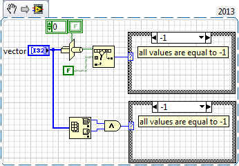

A cup of coffee and a few minutes give me two possibilities
"Type cast - search" halts at the first True but needs to compare all values in the case we desire to find.
"Min/Mix- And" might benchmark better in certain situations.

Jeff·Þ·Bohrer wrote:
Thankfully I got some excellant code review processes (Gerd and Tim) backstoping my play.
You forgot Christian in that list as well.  But since you put out the challenge...
A trick I often do is use a FOR loop to do the comparison.  Starting with 8.6 (or was it 8.5?), you can right-click on the FOR loop and make the conditional terminal viewable.  So I just do the comparison one item at a time and quit when I find the bad apple.  This way you only check as many as needed.
Message 9 of 10
(4,968 Views)
It also doesn't work of you have a value other than 0 in each byte of the array.  I'm playing with I32 (just needed to put that out so we are on the same page).  So a value of 0x1111 1111 (286331153) when type cast into a boolean array will give {T, T, T, T}.  Anything other than a 0 is a True (C does the same thing).  And your search for a False will fail, giving a false positive of all -1.
