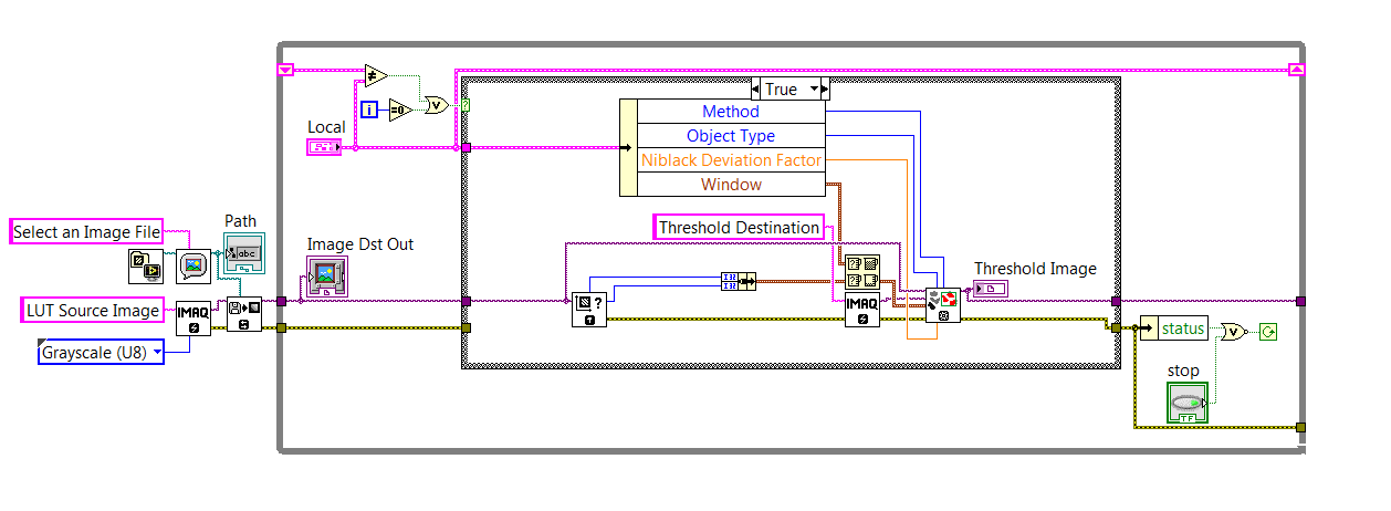

Below is the VI shown that I using an grayscale(U8) at the beginning as input after doing the process of tresholding the output Image was change from a grayscale image to a binary Image but then the problem now I don't know how to convert it back to grayscale. Thank you

Dont have labview up right now but image processing is a little different than typical wires in labview.  If you want to preserve the original image, create a new image for the destination of the binary threshold (Imaq create) and the original image will be untouched.  If you do not do it this way your original image will be lost.

I do create a new image for the destination of the binary threshold (Imaq create) and also the original image. Now the original image was remain untouched as shown figure below. But then after I do all those image processing stuff now I want to convert the processed image from binary  back to grayscale for further usage.

What we mean is create a new Image reference (purple wire) to do the processing on, then put info back onto the original image wire on the display if you want using the other reference (purple wire) if you want to highlight a rectangle, text, show a line or something else.

Thanks Guys finally I got the idea and what to do next. Thank for your help I am appreciate on it.

the imaq image is a different type than the typical wire in labview.  Takes a little time to get used to.  If you dont want to loose the data on the wire, you need a new image for your results (you will find you need an IMAQ copy where you used to beable to split a wire).  Once you grasp this difference it will be smooth sailing.
