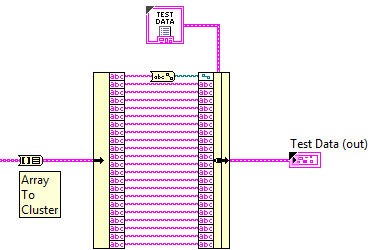

Here is a screen shot of my code:
I read back my test data as an array of strings which I convert to a cluster, bundle then send off on its merry way to do other stuff, however the first element in the cluster is actually a path. As you can see I currently unbundle all elements, change the first to a path then re-bundle with the correct data types. Whilst somewhat messy, this used to be acceptable as I only had two other strings in the cluster, however due to expansion I now look at it and think that there must be an easier, more elegant way to do this if I just want to change one element.
If this is the only way (or at least if no other simpler solution exists) then I could potentially keep the path a a string and do the conversion at the points that require it, however that would now require a bit of re-coding which I would like to avoid if possible.
Hopefully I'm just not thinking hard enough on this one.
Cheers for looking
Mitch

Hi crossrulz,
Firstly cheers for the reply, much appreciated.
Forgive my stupidity but how would indexing the array solve this as I would still have to bundle each element? A standard unbundle and bundle also can't be used as it requires the original cluster data type which is why I was forced to do the method shown which forces the bundle into the new data type cluster constant. Hope that makes sense.
I do agree thought that indexing the array stops you forgetting about setting the correct cluster size which is a pain in the backside as it doesn't complain that you the have more input elements than the wired output cluster but will still let you run! I've stung myself enough times not to make that mistake anymore Smiley Happy
The FOR loop idea would and does work as I already tried that before posting this question, however its more cumbersome than I would like, especially for its intended purpose.
Thoughts, comments?

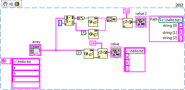

I have no idea what the rest of the code looks like and how much you can change so a few options:
1.  Keep them all as strings, do the path conversion when you actually need the path.  I'll show you the trick I use to convert arrays to nicely labelled clusters below.
2.  Make the cluster an object, keep the data as a string array and the accessors deal with indexing and path conversion.
3.  Make the cluster hierarchial, separate the path and have a second cluster which is all strings.
4.  If you want you can jigger the string array and use some flatten and unflatten action.
The top of the snippet is one way to jigger the string array to get a path for the first element in a flat cluster (should wire seamlessly to the rest of your code).  The lower code shows how I would convert a string array to a cluster so the labels are useful, same idea works for clusters which are given useless labels such as those from Array to Cluster.  (Fixed sized clusters with brown wires are easier to handle, simply Type Cast to the cluster with the same types and appropriate labels).
Judging from your original post, you know when and how to Type Def the various clusters I show.
(7,191 Views)
Hi Darin.K,
Your top method in the code snippet has resolved my issue and I would never have thought of doing it like that. That is one for the memory banks so cheers!
