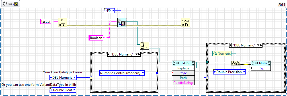

I'm probably missing something, but why is the solution with Replace method not easy enough? (Snippet below, sorry for its dirtiness)
Ok, you have to make some coding for each data type and decide which control you use. But there is no "Generic Boolean Control", just "Push Button", "OK Button", "Round LED", "Square LED"... So any solution would need you to decide what control you will use exactly - even the one with creaing temporary control you described.

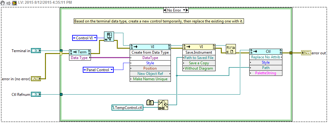

My data type is not known at run time.  What if I have a string control and I want to replace it with an array of a cluster that contains an error and a string?  Or an enum?  I want the generic solution.  I have a control on the front panel, and I want to replace it with the data type found on this terminal, not caring about how it looks on the front panel.  All I care about is the interface.
The solution I found is one I partially described in my Edit, which looks like the following and was used in this right click function.
https://decibel.ni.com/content/docs/DOC-43671
