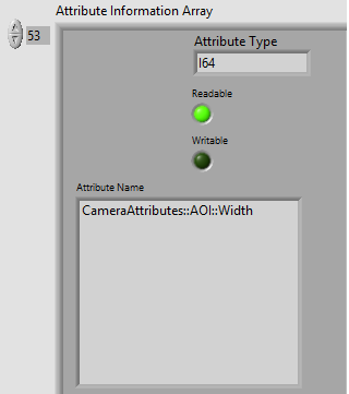

I did the next steps:
1. I use enumerate attributes to get name of width atributte:Sin título.png
2. I try to set attribute with the next code and return this error:Sin título2.png
It make sense because in enumerate attributes it says that width attribute is only readable.
However I can change this attibute in NI MAX (see first post image) because when I change this attribute in NI MAX and then I go to my labview program and read width attribute, the value has changed....
So why can't I change this value in labview program with imaqdx properties? How could I do this?
Thanks a lot.
