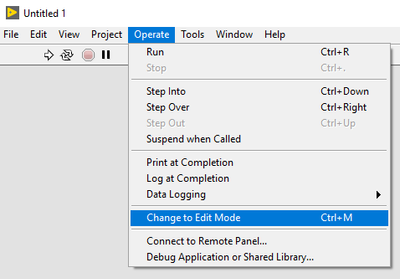

A VI usually opens in run mode when it is set to reentrant and you double-click one of its clones on a diagram. I also find this quite painful when navigating the code (especially in FPGA where everything is reentrant by default).
The easy solution is to press ctrl+M to switch to edit mode each time you open a VI.
The not-so-easy solution is to create a right-click plugin to open the original VI directly.
Here is an example plugin that adds a "Diagram" option when you right-click a SubVI in the code. It only opens the original diagram, so no clone and no front panel.
Put both subfolders in "<user>\Documents\LabVIEW Data\PopupMenus", then restart your LabVIEW. It should work for versions >= 2016.
Also, there is an exception for malleable VIs, it opens the instance instead of the original.
