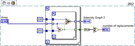

woohoo...an opportunity to use auto-concatenation.
Message 7 of 12
(4,808 Views)
Why? "Boolean to 0,1" and "Add array elements" works equally well with 2D arrays. No concatenation needed. 😉
Also note that boolean to 0,1 outputs I16, so if the array is large, you might run out of headroom. I would convert to I32 before summing.
(In fact, since you only need a scalar count, it might be more memory efficient to maintain a running sum in a shift register. No second array needed.
I would also recommend to make the diagram constants U8 to (1) avoide coercion and (2) use 4x less memory.
Message 8 of 12
(4,795 Views)

Here's a code skeleton that can easily be adapted to other datatypes if needed. (AS mentioned, the flattened string version only works well for U8).
Message 10 of 12
