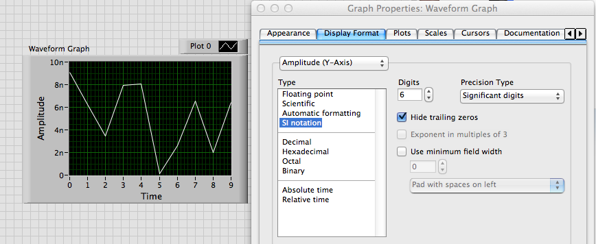

Pratheek,
I am not sure exactly what you want.
If you just want the scale to change to read 10n or 5u, use the scale format property set to SI Notation.
If you want to change the text of the scale name label, you use the YScale.NameLbl.Text Property. The attached VI shows one way to do something like this.
Lynn
