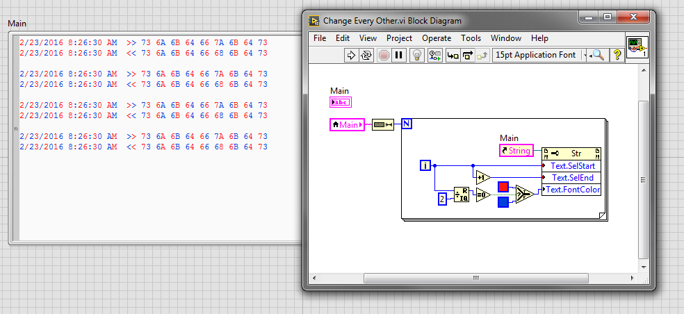

See how this code changes every other character to red or blue. See? It can be done, you just need to apply it to the lines you want to change.
This takes some time, so if your string gets really long, you'll have issues.

@jay0909 wrote:
   Thanks for the solution. I tried some work around. But  the previous strings are in default colors. Any ideas to make it work.
Come on man... For the third time, the colors get reset every time you set the string value. You need to set the color of each line every time. Look at the For loop I gave you in my last post. See how it loops through the string multiple times and sets each color.

       I tried with the for loop but the program really works very slowly.
