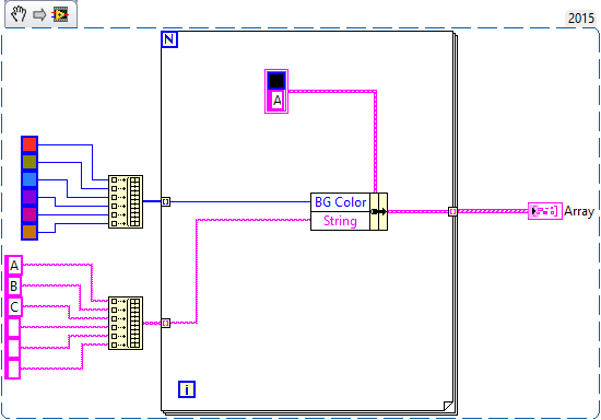

If you do want to change BG color as well there is always using an array of clusters with a color box and string in the cluster.  See attached.BD.png
