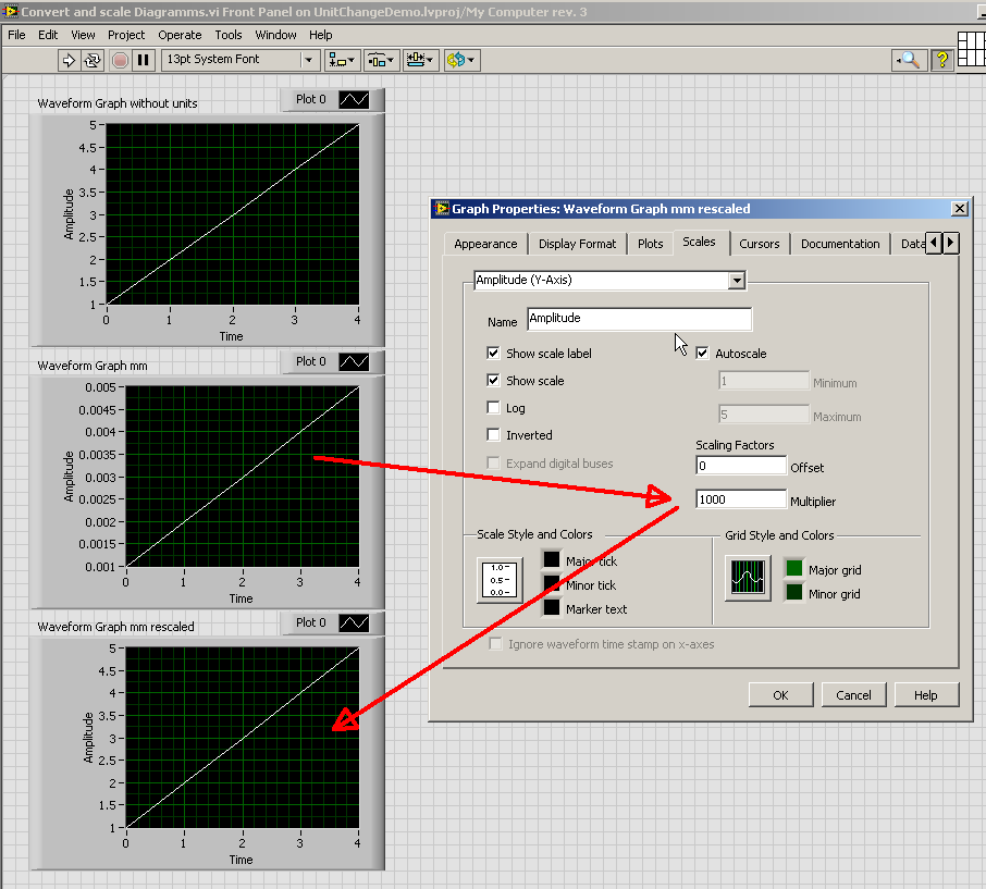

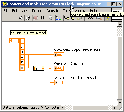

Let's assume your example and let's say the array  contains values representing 1 to 5 mm. The array itself has no units but we know it is mm. That means I would like to see it in mm in the plot. In my example the first waveform  graph. Now I convert to mm and simply copy the graph and wire from convert. Now I see  0.001 to 0.005  on the Y-Axis. After rescaling it is ok. Did I missed something ?.
Message 9 of 19
(8,373 Views)

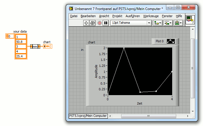

Hi Jörn,
could you PLEASE attach non-scaled graphics (for the FP)?
It seems you fiddled with multiplier/offset setting of the scale. Don't do this when you want to show numbers with units, the scaling is already done by the unit display:
Numeric data is unit-casted to "mm" and shown in "inches"...
And you should make the unit display visible (as in my picture, the small "in" left of the chart). That way you can easily change the shown unit!
