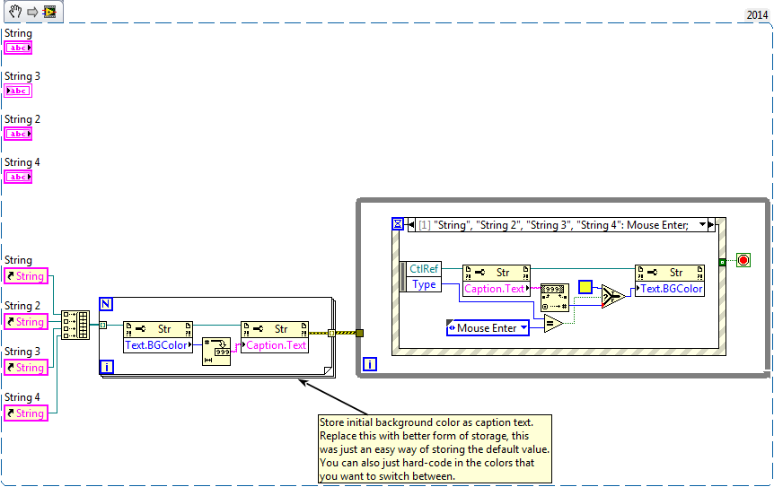

Use an event structure with the Mouse Enter and Mouse Leave events. You could combine all the events in to one event case and use the Control Reference output for the event to change the specific control's color.

1. Go give this idea a Kudos: Key focus Event
2. You could do something like this in a loop
(5,599 Views)
That idea deserves Kudos indeed.
If your user will be tabbing between controls, OP will have to poll the focus just like crossrulz suggests.
If mouse events will be satisfactory, the best way to do this would be with an event structure, so your polling isn't using up processing power.

Thanks, that works exactly as I wanted. Thanks also James for your input.
