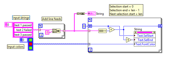

I agree a table would be much easier. Here is an example of how you could do it in a single string

That works great! Thank you!

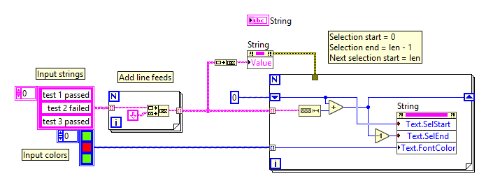

Just one follow up question if I may ... when I feed the output string into a local variable the colors are lost. I'm using a local because I write to the 'status' text box from various places in the program.

You have to make sure the value of the string is updated before you start selecting parts of it. You could do this with a local variable and a sequence structure, or with a property node. The error wire below makes sure the For Loop doesn't run until the value of String has been updated. Property nodes are a bit slower, but if this is something you write once after a couple of tests, you won't notice.
Disclaimer time: if you find yourself having to use local variables and value properties a lot, then you are probably just "programming as you go" and not planning out the application enough. Once you plan it out and use a reasonable design pattern, you will be writing to the terminals most of the time.
