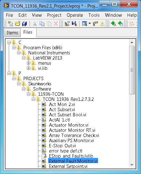

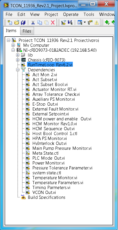

I have labview installed on my local PC's C: drive.  But all of my files (Virtual Instruments, libraries, controllers, and such) are on the departments file server.  This way they can be easily worked on be every engineer in the R&D department.  I have this file server mapped as a P: drive.
I get this error message sometimes when I'm tiring to open up a top level VI 1st thing in the morning.  Other times when I try to open up my top level Real Time VI, Labview just crashes, because that VI has become corrupt.  I think these may be related.
