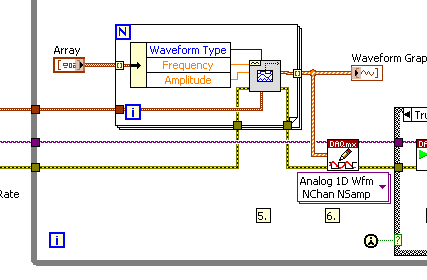

You will need to slightly modify the code to work with multiple channels.  It will end up looking something like this:
The above would allow you to give an array of Sine/Square/Triangle/Sawtooth wave parameters for the different channels and update them on the fly based on user inputs.  Since your signals are all being defined differently, you might need to change up the code a little bit, but the idea is that you write all of the channels at once with new data to be generated.

It isn't possible to only write to one of the channels at a time in a hardware-timed operation.  Since the analog output circuitry shares a single timing engine, all clocked analog output lines must be in the same task. What I was getting at in my last post is that you can continue to output any desired signal to your channels in this task.  This signal is defined in software, so if you want to only change a single channel it would certainly be possible to only adjust one channel in your array of data and continue to output the same data on the other lines.  This is what the code should do that I posted in my last post.
Also, you can put software-timed Analog Outputs in seperate tasks.  Software-timed Analog Outputs will only allow you to write a single value at a time (but you can write over and over based off of a software loop).
What exact signals do you need to generate?  For function generation (sine wave, sawtooth, etc.) you should probably use a hardware-timed, buffered operation mentioned in my first post.  The user could change the parameters of these signals on-the-fly since the data is constantly being streamed to the board.  The datatype being used in my last post is a 1D array of waveforms--every element is the waveform that will be written to a different channel in the task.  To turn a channel "off" just set this waveform to output 0s.

How did you build the cluster that gets unbundled in your example?
I tried to use an array but i couldn't get the Waveform Type:string inside it :-(, with cluster i can use only one (?) user Panel?
Can you please give some insight how to build the input cluster? Thank you!
Message 6 of 8
(4,935 Views)
Two things here. FIrst this thread is from 2009. You should start a new qestion asking this.
THe second is you use a custer not an array. The cluster is located int he cluster palette.
