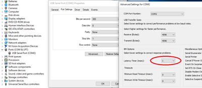

can you please show how/where you set that "latency timer" on your computer?

Hi Gerdw,
Thank you for your concern.I have attached the image below.

Hi worker,
ahh, learned something new…
Why do you think a USB (virtual COM) port setting will be relevant for the myRIO?
It's UART lines are directly connected to the ZYNC7010 and don't run over an USB bridge…
