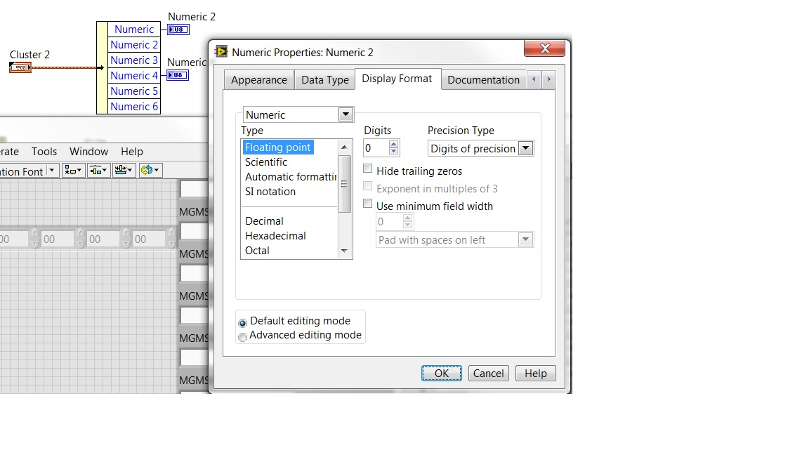

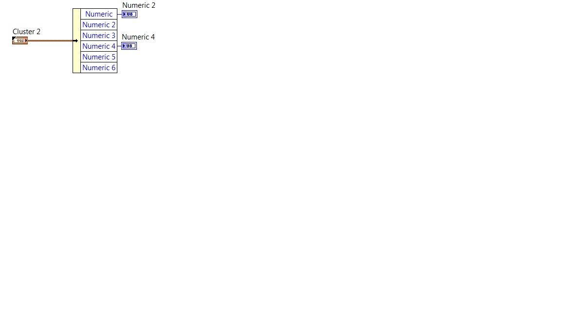

Numerics 2 and 4 are U8 in floating point, the type def (when opened) numerics are all Hex. (display format).

So the cluster is a type def and the numerics are not type defs?  If you want the display format to change on the numerics you need to make a strict type def of one numeric then use instances of it for all the numerics in your cluster type def and the indicators that display the data from the cluster.  That way you only have to change the format of the strict type def numeric to change the4 format of all the numerics.
You say numerics 2 and 4 are U8 in floating point.  That's not possible.  U8 is not floating point and floating point is not U8.  Your picture shows them as U8, not floating point.  A single, double, and extended double are all floating point.  Signed and unsigned intergers are not floating point.

Thank you for getting back to me so soon!  I will try building a strict type def of one constant/control first then build the cluster as you suggest.  thx.
Note the display format is floating point...weird huh?
